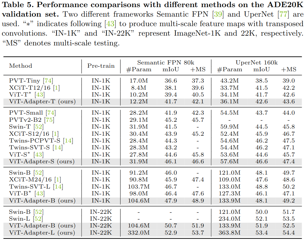

      语义分割
      image-20220522160618021
      image-20220522160640347
      image-20220522160653003
