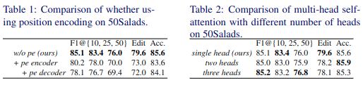

      Ablations of the number of blocks
      image-20220605210643730
      image-20220605210654741
      image-20220605210710257
      image-20220605210722970
