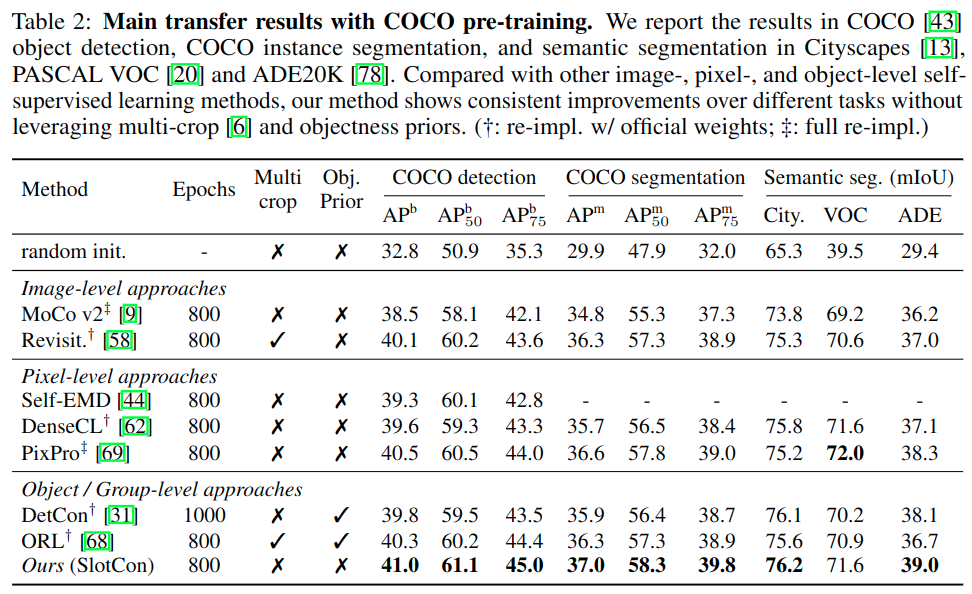

      预训练结果:
      image-20220630213317342
      image-20220630213329979
      image-20220630213342614
