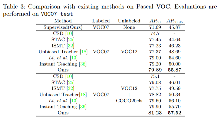

      Main Results
      Comparison with State-of-the-arts
