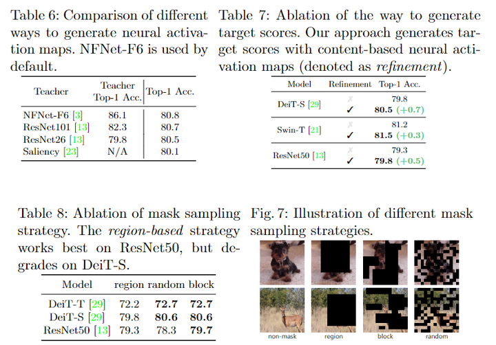

      ImageNet Results
      Transfer to Downstream Task
      Main Properties
      Ablative studies
