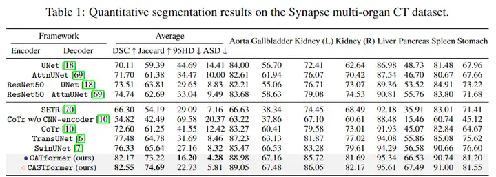

      Synapse Multi-organ

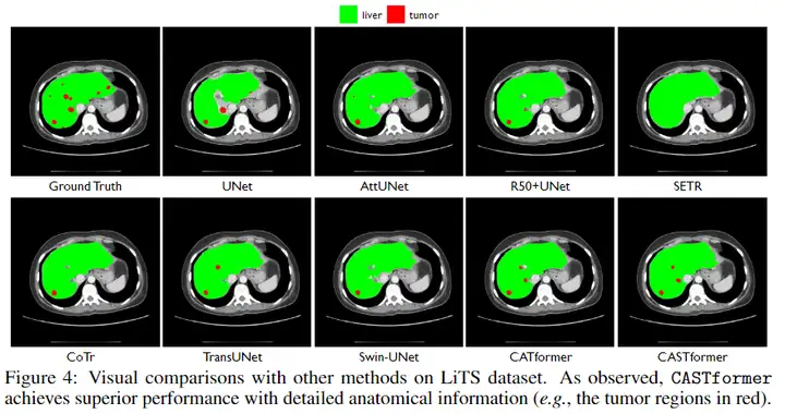

      LiTS

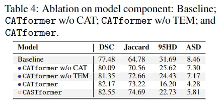

      Ablation of Model Components
