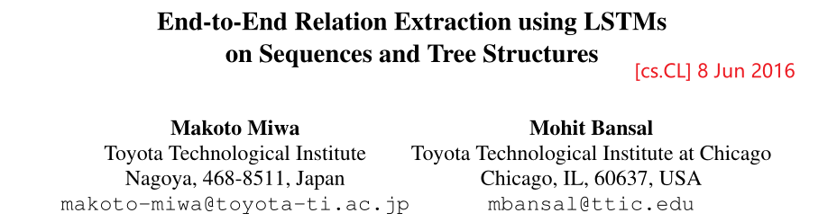

    基于LSTM的序列和树结构端到端关系提取
    46
      End-to-End Relation Extraction using LSTMs on Sequences and Tree Structures
