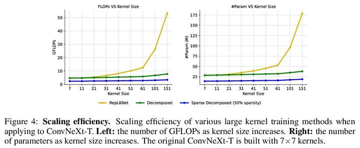

      摘要:利用稀疏性将卷积核扩大到51×51以上、K均值掩码Transformer、基于编译器中间表示的代码翻译、面向行动定位的协同微调、目标检测中是否该对所有候选区一致看待、哈佛USPTO专利申请数据集、神经语言模型并非天然能拟合大脑数据但训练仍有帮助、现实半监督学习研究、基于图拓扑采样的图卷积网络训练泛化保证
      1、[CV] More ConvNets in the 2020s: Scaling up Kernels Beyond 51x51 using Sparsity
      S Liu, T Chen, X Chen, X Chen, Q Xiao, B Wu, M Pechenizkiy, D Mocanu…
      [Eindhoven University of Technology & University of Texas at Austin]
      利用稀疏性将卷积核扩大到51×51以上。自从视觉Transformer(ViT)提出后,Transformer迅速在计算机视觉领域大放异彩。卷积神经网络(CNN)的主导作用似乎受到了越来越有效的基于Transformer的模型的挑战。最近,一些先进的卷积模型在局部强注意力机制的激励下,以大核的方式进行了反击,显示了吸引人的性能和效率。其中的一个,RepLKNet,令人印象深刻地设法将核大小扩展到31×31,并提高了性能,但与Swin Transformer等高级ViT的扩展趋势相比,随着核大小的继续增长,性能开始饱和。本文探索了训练大于31×31的极端卷积的可能性,并测试了是否可以通过战略性扩展卷积来消除性能差距。这项研究最后从稀疏性的角度提出了一个应用极端大核的方案,可顺利地将核扩大到61×61,且性能更好。在此方案基础上,提出了稀疏大核网络(SLaK),一种配备了51×51核的纯CNN架构,在ImageNet分类以及典型的下游任务上,可以与最先进的分层Transformer和现代ConvNet架构(如ConvNeXt和RepLKNet)的性能相当或更好。
      Transformers have quickly shined in the computer vision world since the emergence of Vision Transformers (ViTs). The dominant role of convolutional neural networks (CNNs) seems to be challenged by increasingly effective transformer-based models. Very recently, a couple of advanced convolutional models strike back with large kernels motivated by the local but large attention mechanism, showing appealing performance and efficiency. While one of them, i.e. RepLKNet, impressively manages to scale the kernel size to 31×31 with improved performance, the performance starts to saturate as the kernel size continues growing, compared to the scaling trend of advanced ViTs such as Swin Transformer. In this paper, we explore the possibility of training extreme convolutions larger than 31×31 and test whether the performance gap can be eliminated by strategically enlarging convolutions. This study ends up with a recipe for applying extremely large kernels from the perspective of sparsity, which can smoothly scale up kernels to 61×61 with better performance. Built on this recipe, we propose Sparse Large Kernel Network (SLaK), a pure CNN architecture equipped with 51×51 kernels that can perform on par with or better than state-of-the-art hierarchical Transformers and modern ConvNet architectures like ConvNeXt and RepLKNet, on ImageNet classification as well as typical downstream tasks. Codes: https://github.com/VITA-Group/SLaK
      https://arxiv.org/abs/2207.03620

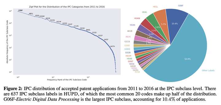

      [CL] The Harvard USPTO Patent Dataset: A Large-Scale, Well-Structured, and Multi-Purpose Corpus of Patent Applications
      哈佛USPTO专利数据集:大规模、结构良好、用途广泛的专利申请语料库
      M Suzgun, L Melas-Kyriazi…
      [Stanford University & Oxford University & Harvard University]
      https://arxiv.org/abs/2207.04043

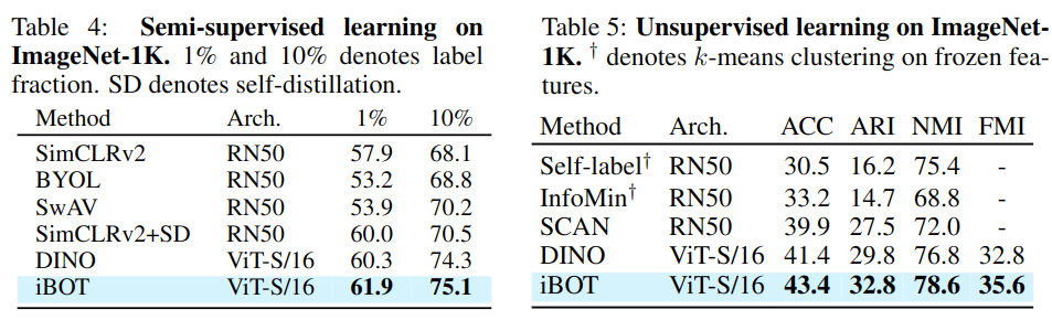

      4. 实验结果: 通过在ImageNet-1K上实现82.3%的linear probing精度和87.8%的fine-tuning精度,并在密集的下游任务(例如,对象检测、实例分割和语义分割)上取得领先的结果。

      ImageNet-1K上的分类任务
      image-20220514210019111
      image-20220514210159884

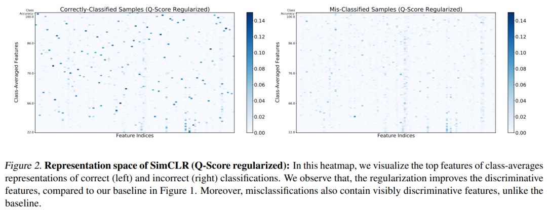

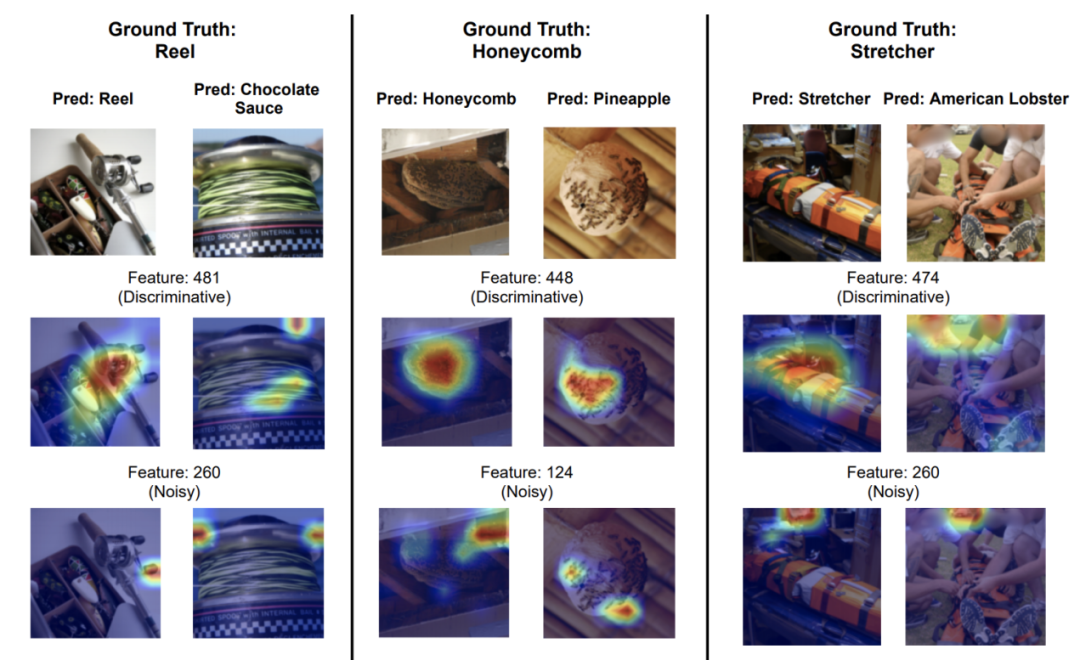

      图1 是训练学到的 ImageNet-100 中每个类的平均特征表示(部分特征),其中每个类是按照该类别的分类准确度(acc)排序的。图中用颜色深浅表示平均特征表示的值的绝对大小,左边是在下游任务中可以被正确分类的样本,右边是错误分类的样本的平均特征表示。
      可以看到,
      1. 表征空间几乎是稀疏的,每个类的大部分特征都接近0;
      2. 在正确分类的样本中,每个类的平均特征表示都有十分明显的几个特征,这些特征是类别所独有的,不同类别的可区分特征都不一致,且不同类别的可区分特征有着高度的差异性,而这一点在错误分类的样本中并不明显,错误分类的样本其特征表示没有明显突出变化较大的特征;
      3. 在所有样本中都存在或者都激活的特征不太可能是下游任务中用于区分某个类别的特征。
      为了研究单个特征对分类正确与否的影响,作者进一步绘制了主要特征和噪声特征的热图,如下所示:
      可以看到对于正确分类的样本,主要特征能够捕捉到类别相关的特征,而分类错误的样本,主要特征则包含了太多的噪音和错误的信息;噪声特征的热图则侧重于样本中无信息的部分。因此,作者指出特征表示中包含了很多噪声特征,这些特征对正确分类没有太多的贡献。

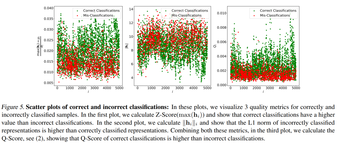

      • max(hi)max(h_i)max(hi​)的Z 分数:逐元素地计算 hih_ihi​ 中最大值并计算 Z 分数,
      为评估以上指标在衡量下游任务中分类效果的好坏,作者研究并绘制了多个sota自监督模型(包括SimCLR、 SwaV、MoCo V2和BYOL)的特征表示关于上述指标的ROC(receiver operating characteristic)曲线和PR曲线。此外,作者还计算了相应的AUROC(ROC曲线下的面积)和AUPRC(PR曲线下的面积)。
      可以看到,L1范数 和 max(hi)max(h_i)max(hi​) 的 分数在各个模型上面都有较为一致的表现,作者进一步可视化了 ImageNet-100 中5000个样本的L1范数和Z 分数。
      可以看到,分类正确的样本的 Z分数普遍高于分类错误的样本,而L1范数则普遍低于分类错误的样本。
      自监督Q分数
      根据前面的实验结果,作者设计了评判特征表示能否容易在下游任务分类正确的质量指标—— Q分数。第 i个样本的 Q分数定义如下:
      Q分数既能衡量出特征表示的稀疏性,又可以判单表示中是否有较高的偏差值的特征(由 Z−SZ-SZ−S core (max⁡(hi))\left(\max \left(h_{i}\right)\right)(max(hi​)) 计算得到)。图 4 和表 1 都展示了作者提出的 Q 分数的性能,可以看出 Q分数在识别下游任务中是否分类正确的特征表示上确实效果明显。

      特征表示
      作者展示了 Q 分数正则化后的自监督模型的特征表示,如下所示:
      和没有用 Q分数正则化的特征表示(图 1 )相比,图 2 的特征表示中的主要特征更加明显;图 7 显示的没有区分分类正确与否的类平均特征表示,其中的特征有了明显清晰的区分;在表 2 中,作者给出了使用 Q 分数正则化前后的AUROC和AUPRC的对比,可以看到,使用 Q 分数正则化后,这两个指标都有明显的下降。以上都证明了 Q 分数正则化的有效性。
